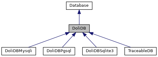

Inheritance diagram for DoliDB:
Collaboration diagram for DoliDB:
