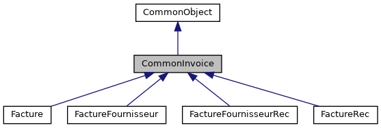

Inheritance diagram for CommonInvoice:

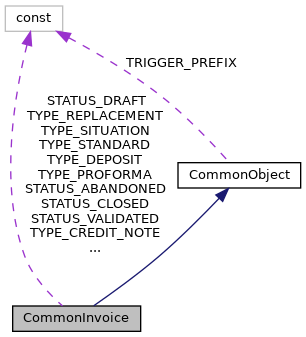

Collaboration diagram for CommonInvoice:
